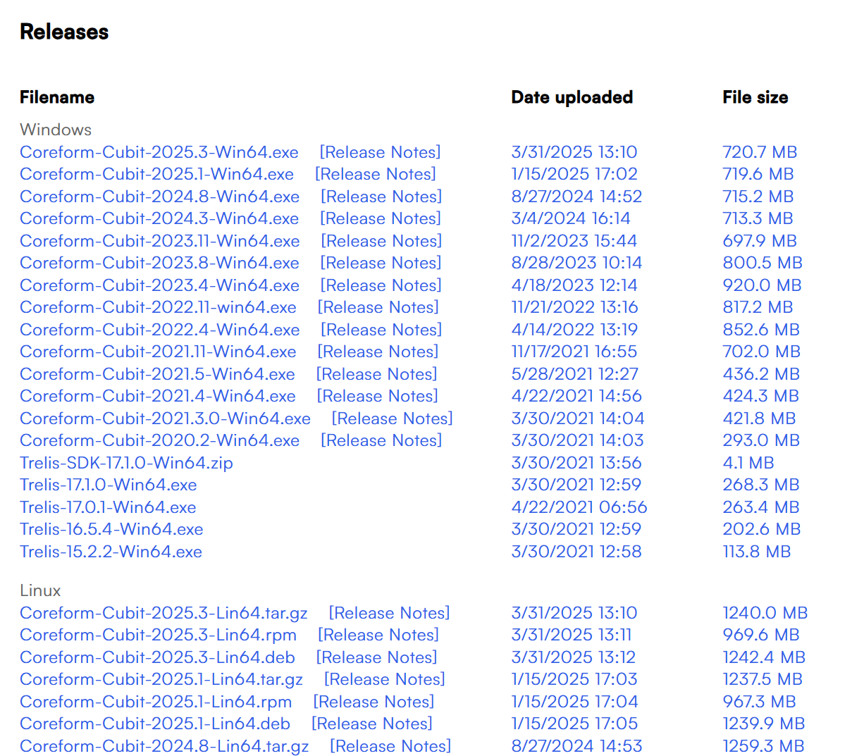

Download Coreform Cubit and install it on each network computer that will run Coreform Cubit.​
  • Your download will begin immediately. Choose “Save File,” select a folder location, and click “Save.”
  • Locate and double-click the downloaded file to launch the installer (look for Coreform-Cubit-“Year of download” (for example 2022.9), followed by .exe, .dmg, .rpm or .deb).

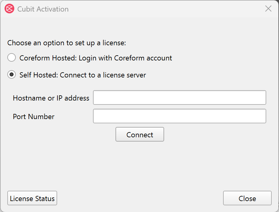

  2. In the Product Activation window, select Self Hosted: Connect to a license server.
  3. Enter the hostname or IP address of the license server where RLM-Server is located. The default port number is 5055. (See RLM-Server Installation Instructions for information about changing the port.)
4. Click Activate. If successful, you will see the following message: Connection to license server succeeded, press close to continue.
Note: A floating or shared license is only meant to be activated on the machine running the RLM server. Do not use the product key to activate Coreform Cubit on the client computer that is running Coreform Cubit. Instead use the hostname/IP address and the port number of the RLM server.
