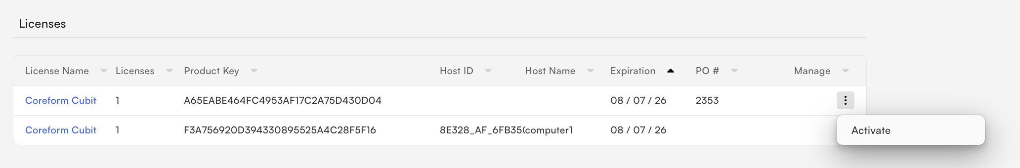

  • You will need your product key for your license found in your account.

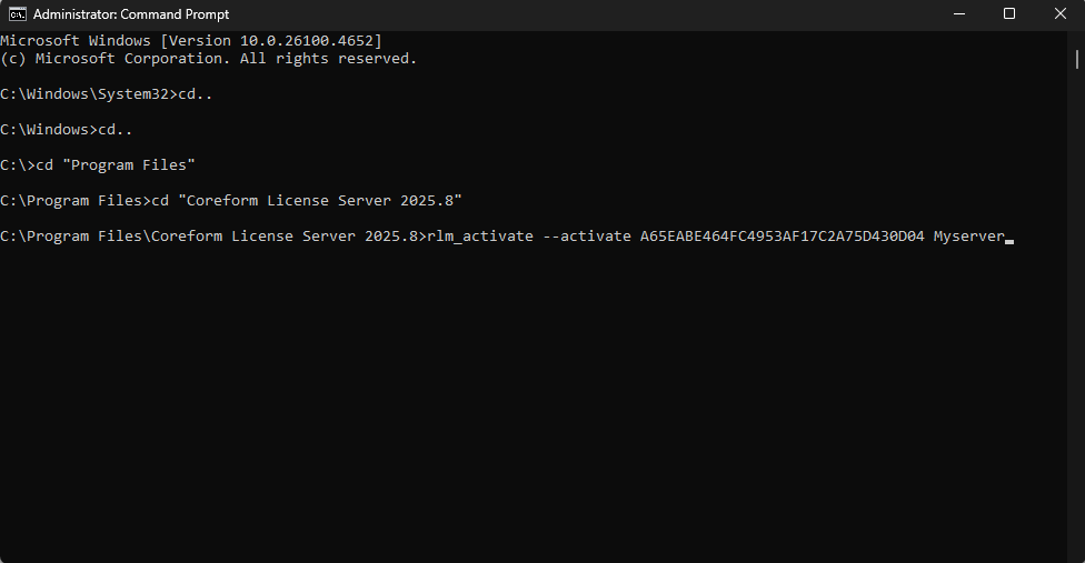

    • RLM Activation GUI. Run rlm_activate to launch the RLM Activate window. Enter the Product Key and Hostname (for identifying your license server on your account). Click Activate.
  • Command line activation. Run as Administrator (Root): rlm_activate –activate <product_key> <hostname> where <product_key> is the product key for the license and <hostname> is the name of the server. The hostname is optional, but will identify the server in your list of licenses in your account page.

3. On a computer with an Internet connect, go to the Coreform Cubit license on your account page and click on Add Activation at the bottom of the page.
4. Enter your Host Name and Host ID, then click Add Activation.
5. The activation will show in your Activations list. Click the icon next to the activation to download the license file.
