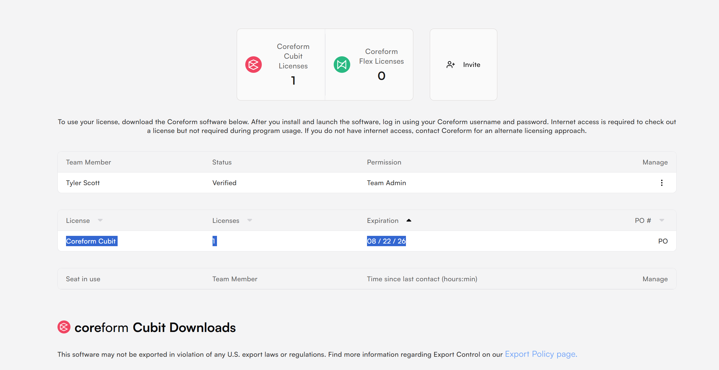

  • Log into your Coreform account
  • Find the license you want to deactivate

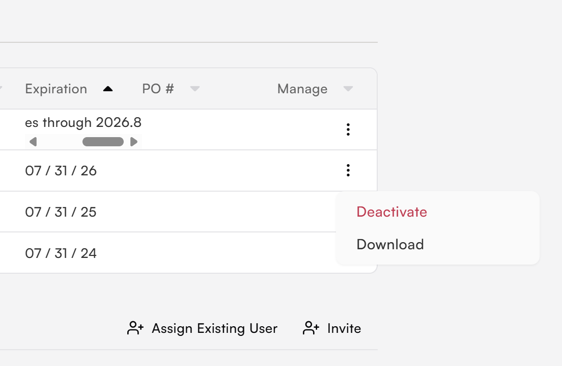

  • Click on the 3 dots and select “Deactivate” on the license you wish to deactivate.
  • Your license should no longer have the option to deactivate, only to activate.
