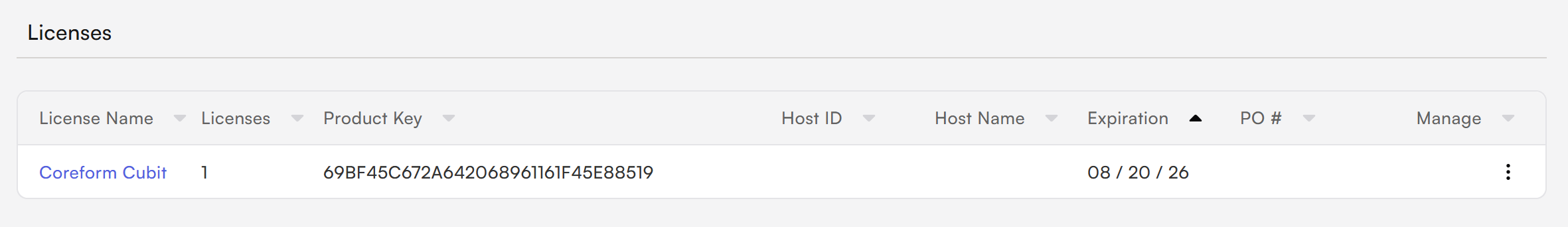

3. On a device with Internet access, go to your Coreform account and scroll down to your Licenses.
4. Carefully record the Product Key supplied in the License section: you will rename your license file to this product key in step #7 below.
5. Hover over the three dots under “Manage”. When “Activate” appears, click it.

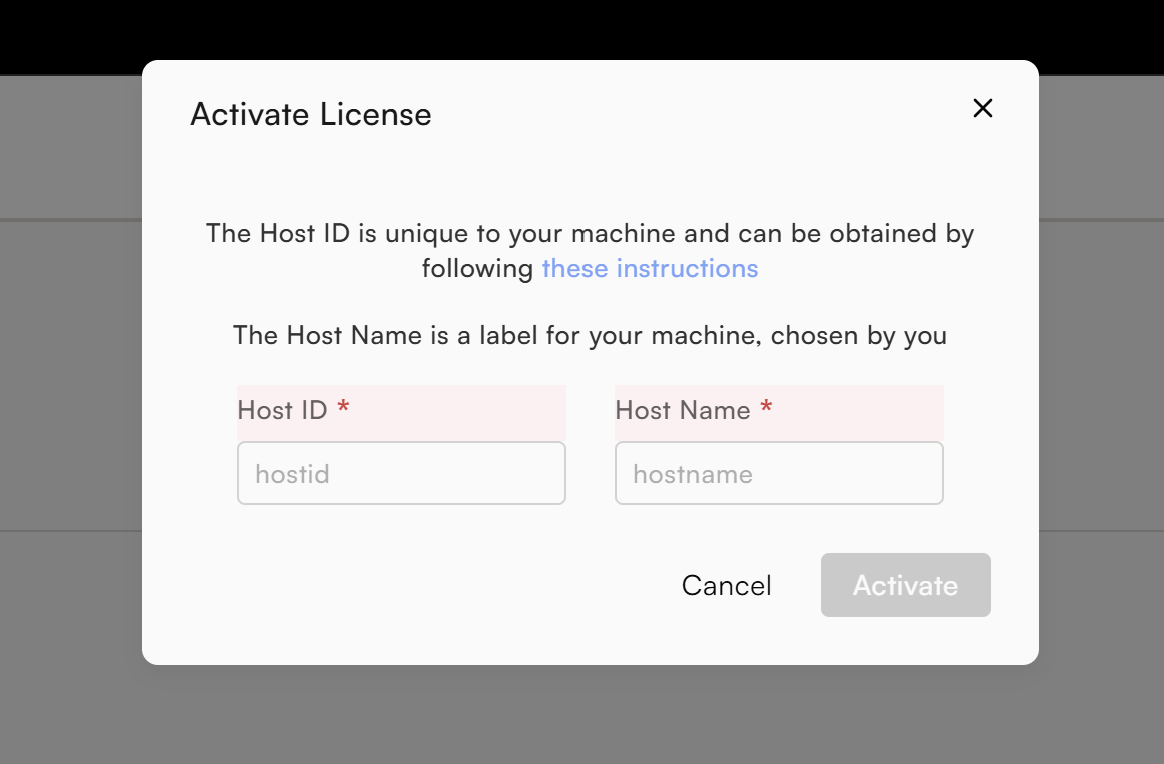

6. In the activation dialog that appears, enter the hostname and hostid of the computer (from step 2 above), then click “Activate.”
