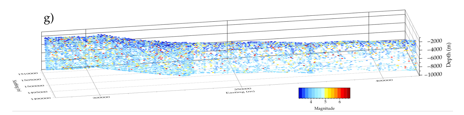

Synthetic seismicity distribution from seismic cycle simulations using the simpler fault-system model.
