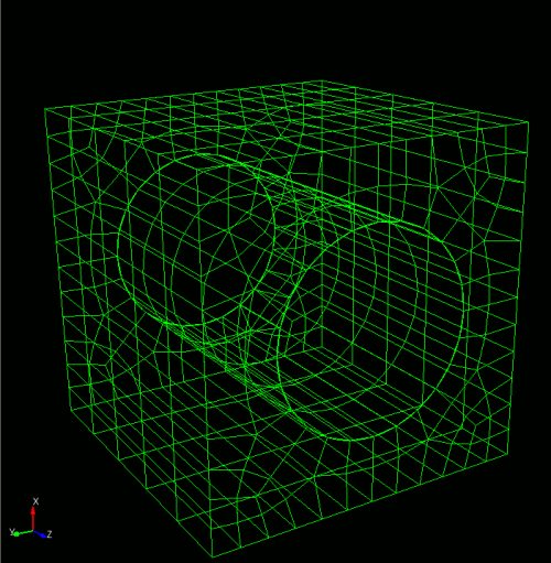

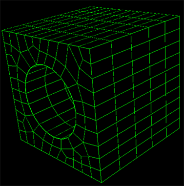

For example, the following two figures result from selecting the Hidden Line and Wire Frame Mode buttons respectively.
Hidden Line View of Mesh
Wire Frame View of Mesh
