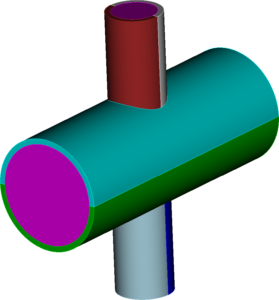

Example 1: Offset without Loft
The following example creates a T-shaped body from two cylinders and web cuts it by offsetting the cylindrical surfaces inward by 0.2 units:
cyl radi 2 z 10
cyl radi 1 z 10
rotate vol 1 angle 90 about x
unite vol all
split periodic vol all
webcut vol 1 offset surface in vol 1 except surf 2 6 3 5 distance -.2
Figure 1. Result of the Webcut Offset command without the Loft option.

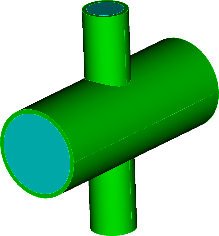

Example 2: Offset with Loft
Adding the Loft option creates volumes between the original and offset surfaces that are directly meshable with the sweep scheme, useful for boundary layer representations:
cyl radi 2 z 10
cyl radi 1 z 10
unite vol all
webcut vol 1 offset surface in vol 1 except surf 2 6 3 5 distance -.2 loft
Figure 2. Result of the Webcut Offset command with the Loft option. The boundary layer volumes are directly meshable using the sweep scheme.
