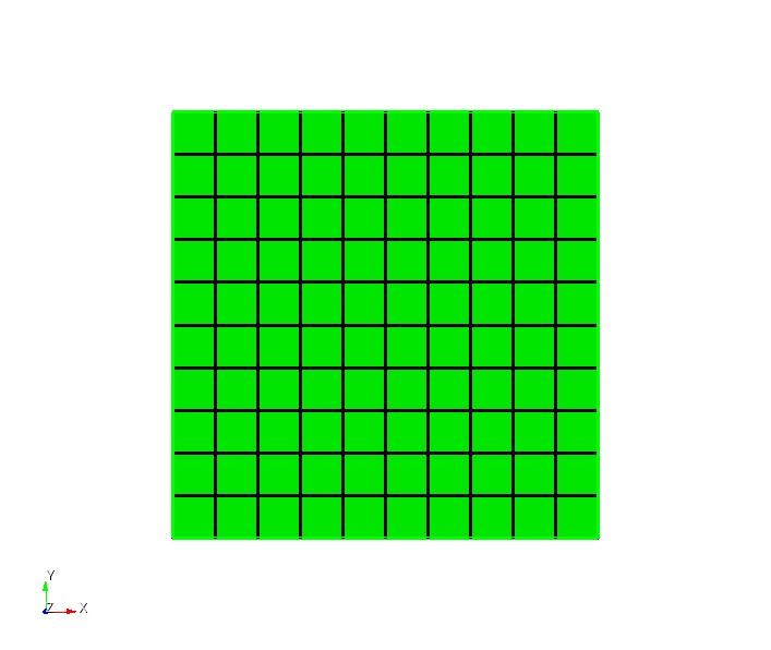

For example, given the following meshed brick:
we issue the command, column open node 89 88 90 , to get this result:

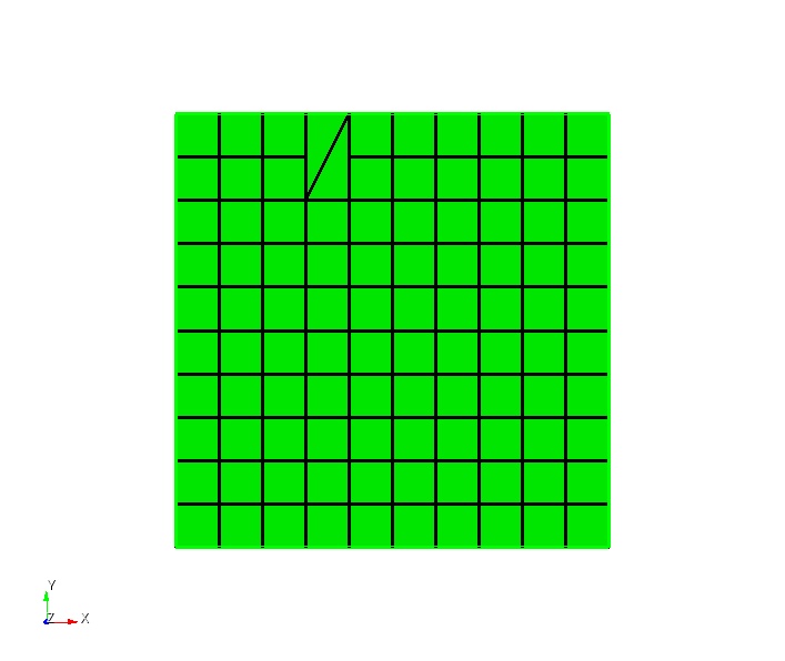

we issue the command, column collapse node 51 59, to get this result:

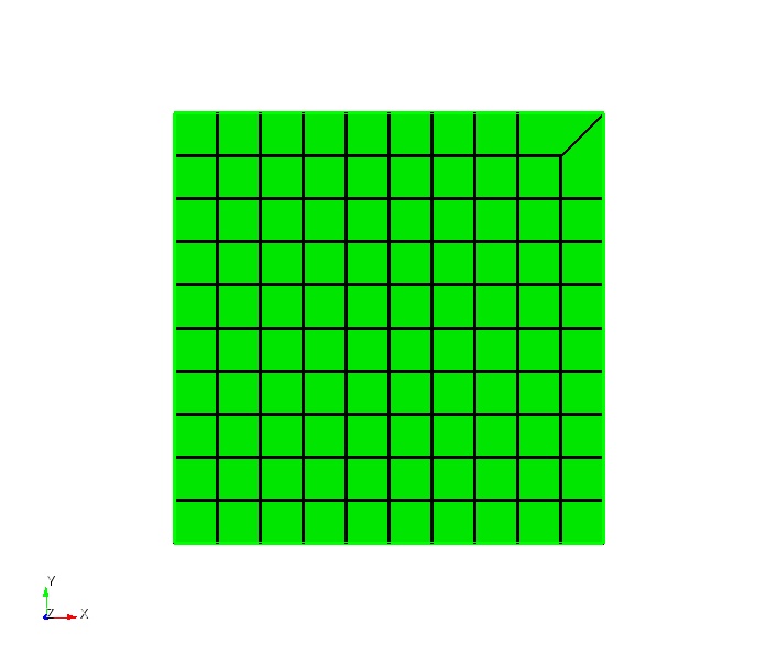

The column collapse command can be used with boundary nodes. For example, we issue the command, column collapse boundary node 13 2 11, to get this result:

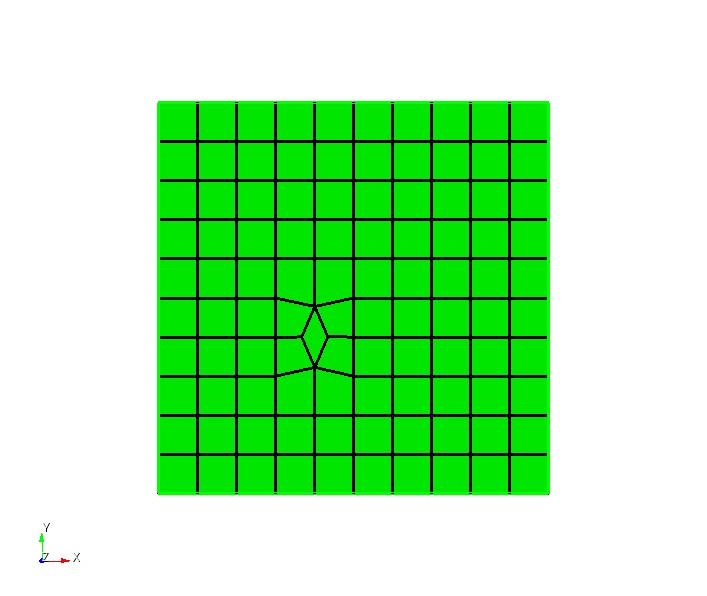

we issue the command, column swap node 103 94 102 18, to get this result:
