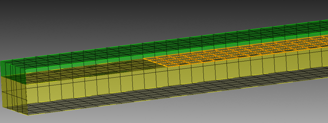

A geometry with highlighted surface indicating location for cohesive elements
The above example has a shared surface between the green and yellow volumes which is already cracked, using the unmerge command in Cubit. The highlighted merged surface can then used for creating cohesive elements. The following command will do so.
Create Cohesive Elements Block <value> Surface <ids>

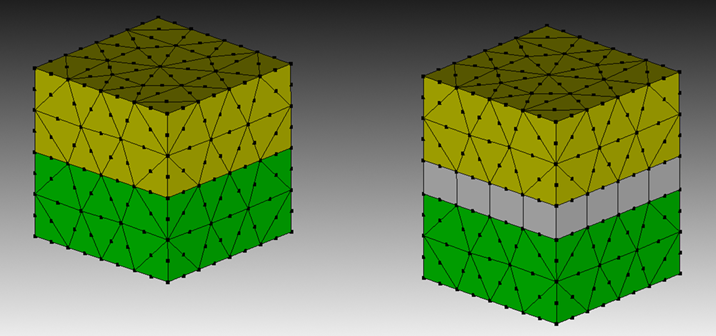

Creating cohesive elements is supported for both hex an tet meshes. In the case of hex meshes, the resulting cohesive elements are also hexes. In the case of tet meshes, the resulting cohesive elements are wedges. For a basic tetra4 mesh, the resulting CSEs are wedge6 elements. For a higher order tetra10 mesh, the resuling CSEs are wedge12 elements. The extra 6 mid-edge nodes are on the top and bottom triangular faces to match up with the neighboring tetra10 elements. See the following image for an illustration of how wedge12 CSEs are inserted, with wedges being stretched for illustration purposes. Normally, they are flat.
A geometry (on left) with CSEs inserted (on right). Note, wedge12 elements are stretched for illustration purposes.
