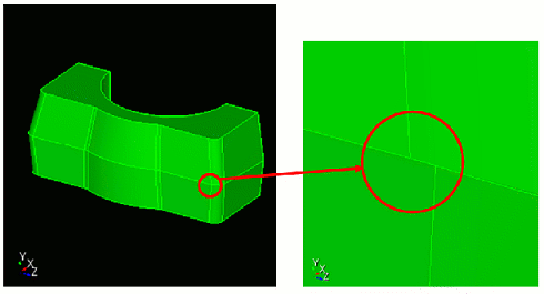

Figure 1 shows a typical example where the collapse curve command should be used to simplify the topology for meshing.
Figure 1. Example where the collapse curve operation is needed.

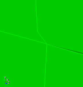

Figure 2 shows the above example after collapsing the small curve
Figure 2. Above example after collapsing the small curve.
