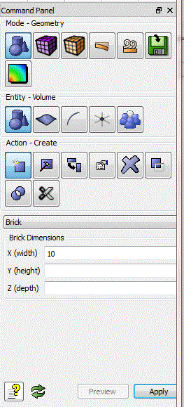

The Coreform Cubit GUI includes a section referred to as the Command Panel. It is comprised of a hierarchy of buttons used to navigate to panels that accept user input and generate Coreform Cubit command strings. The following example shows the command panel used to create a brick. The user navigates to the command panel by pressing the "Mode - Geometry" button, then the "Entity - Volume" button, followed by the "Action - Create" button, then finally selecting the "Brick" option from the pull-down menu.

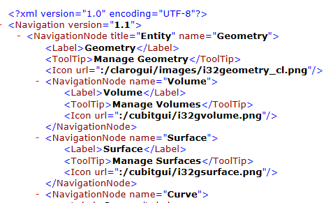

The controlling XML file is named, "Coreform CubitNavigationRoot.xml." A snippet from the file is shown below:
The first two levels of the hierarchy are managed in this file. Subsequent levels of the hierarchy are managed in more specific XML files. For example, the remaining hierarchy associated with geometry volumes is managed in the file named, "GeometryVolumeNavigation.xml." A snippet from that file is shown below:
Users may modify the Label, ToolTip, or Icon url. Users may remove entire categories if necessary. Users should not modify NavigationNode or NavigationReference tags.
