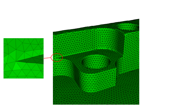

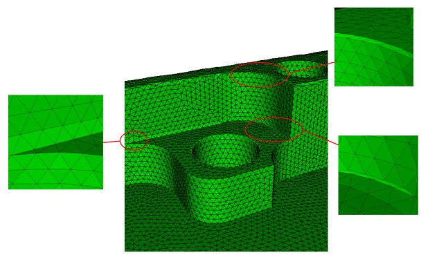

The images below show meshing a surface with and without setting a 'tiny edge length' value. In this example all surfaces have been composited into a single surface. Compositing small surfaces with larger neighbors in conjunction with using 'tiny edge length' has the effect of washing-over small features.
Without using 'remove tiny edge length' triangles with short edges remain.
With appropriate 'remove tiny edge length' value triangles with short edges are collapsed.
