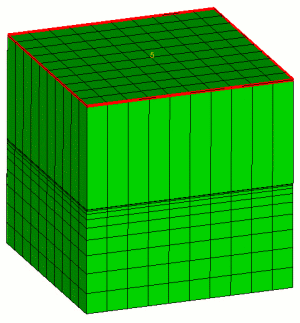

With this command num_layers of hexes can be inserted at the first interval from the specified surface. A bias factor indicating the change in element size must be specified. You must also indicate a first_delta or thickness which represents the distance to the first inserted layer. The mesh in Figure 5 with bias 1.0 and first_delta of 5. The default smooth option provides the capability to smooth the mesh following the refinement procedure.
Figure 5. Example of Boundary Surface Refinement
