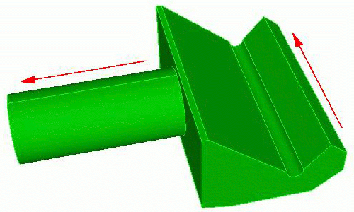

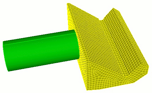

Step 1: Partition the geometry
Figure 1 shows the model that will be meshed. The arrows in the figure show the two intersecting sweep directions. Figure 2 shows the model decomposed for grafting.
Figure 1. A model with two intersecting sweep directions.
Figure 2. The model decomposed for grafting

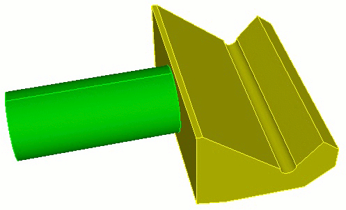

Step 2: Mesh the trunk volume.
Figure 3 shows the mesh of the trunk volume. At this point the mesh on the trunk surface adjacent to the branch surface is a structured mesh that does not align with the boundary of the branch surface. The trunk and branch surfaces are two separate surfaces.
Figure 3. Meshed trunk volume.

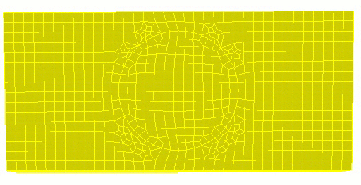

Step 3: Graft the branch onto the trunk
Figure 4 shows the trunk surface after it has been modified to fit the branch surface. At this point the two surfaces have been merged together.
Figure 4. Trunk surface after grafting.

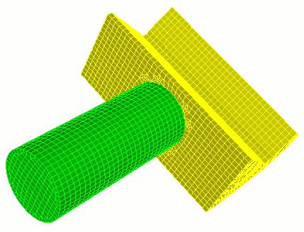

Step 4: Mesh the branch volume.
The final mesh is shown in Figure 5.
Figure 5. Final mesh
