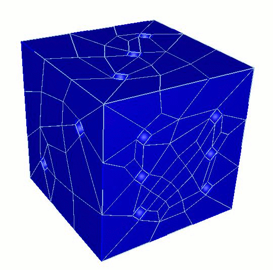

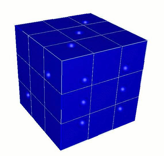

Shown below is a model of a game die meshed with identical mesh size, with details included (left) and removed (right).
